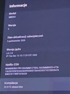

pionier123 Posted December 14, 2020 Share Posted December 14, 2020 Pl.2926 Link to comment Share on other sites More sharing options...
Cacper Posted December 14, 2020 Share Posted December 14, 2020 Mój Mi Box 4K też ma taką wersję, dzięki za odpowiedz. Link to comment Share on other sites More sharing options...

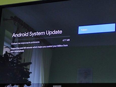

pkonrad Posted December 25, 2020 Share Posted December 25, 2020 Nowy ROM dla Mi Box 4k - kompilacja PI.3175 release-keys 1 Link to comment Share on other sites More sharing options...
