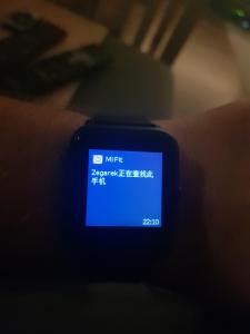

tomurbanowicz Posted November 19, 2017 Author Posted November 19, 2017 Szkoda będzie mi tylko tego "Znajdź telefon"...
