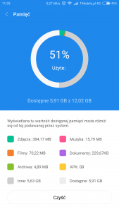

KutanG Posted October 15, 2016 Share Posted October 15, 2016 Wytłumaczy mi ktoś co zajmuje tyle pamięci? Link to comment Share on other sites More sharing options...
