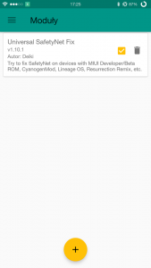

SLiM Posted June 24, 2017 Share Posted June 24, 2017 (edited) Dla tych co maja dalej problem z safetynet pass w miui może ten fix pomoże Magisk v12 + universal-safetynet-fix-v2-beta-1.zip Spoiler Edited June 24, 2017 by slimdick 1 Link to comment Share on other sites More sharing options...
