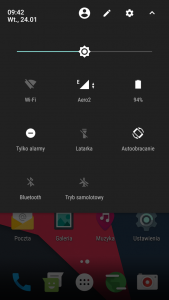

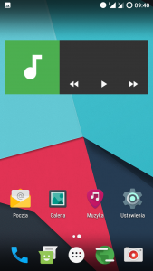

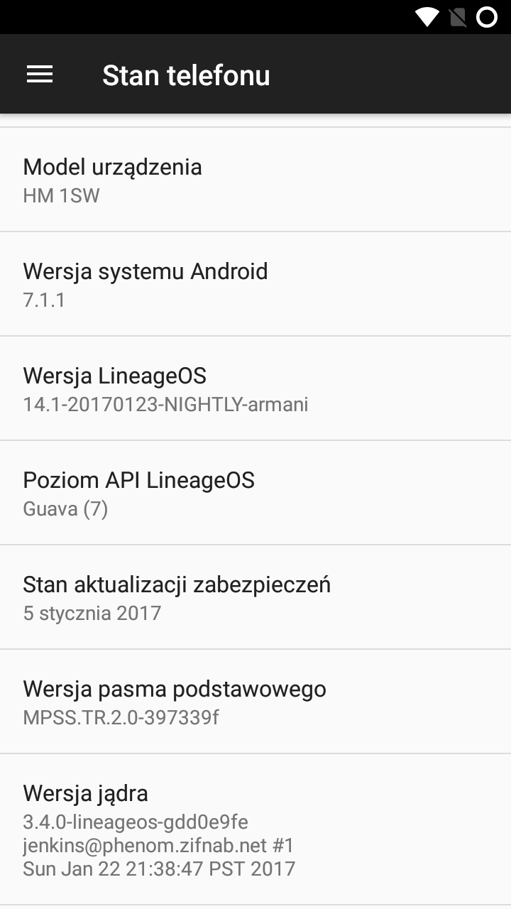

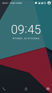

asffaf Posted January 24, 2017 Author Share Posted January 24, 2017 Przeszedłem z ostatniego CM. Wrzuciłem rom TWRP , wipe cash + gapps z CM i wszystko poszło bez problemu. Redmi 1s służy mi jako awaryjny, do testowania CM/ LineageOS. Wydaje się być szybszy od CM . Link to comment Share on other sites More sharing options...

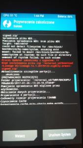

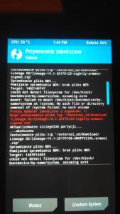

Mariusz21_21 Posted January 24, 2017 Share Posted January 24, 2017 (edited) A mi błędy wywala. Nie idzie tego zainstalować. Edited January 24, 2017 by Mariusz21_21 Link to comment Share on other sites More sharing options...
asffaf Posted January 25, 2017 Author Share Posted January 25, 2017 Pobierz rom z xda. Obecnie masz cm czy miui? z Mi4 Link to comment Share on other sites More sharing options...
Mariusz21_21 Posted January 25, 2017 Share Posted January 25, 2017 Miui v8. Link to comment Share on other sites More sharing options...
Mariusz21_21 Posted January 26, 2017 Share Posted January 26, 2017 (edited) Co źle robię? Edited January 26, 2017 by Mariusz21_21 Link to comment Share on other sites More sharing options...
asffaf Posted January 26, 2017 Author Share Posted January 26, 2017 A spróbuj wgrać najpierw cm. z Mi4 Link to comment Share on other sites More sharing options...
fredek Posted January 27, 2017 Share Posted January 27, 2017 11 godzin temu, Mariusz21_21 napisał: Co źle robię? Nie zapomnij uaktualnić firmware modemu. Do mnie też wrócił mój stary Redmi 1S i też się bawię Link to comment Share on other sites More sharing options...
asffaf Posted January 27, 2017 Author Share Posted January 27, 2017 (edited) Firmware 8.1.2.0: https://www.androidfilehost.com/?fid=529152257862685179 Edited January 27, 2017 by asffaf Link to comment Share on other sites More sharing options...

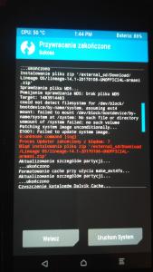

Mundi Posted December 17, 2017 Share Posted December 17, 2017 Hey. Wszystko robię tak jak na filmie wyżej, to przy aktualizacji romu wyskakuje mi error 7 ! Nie kumam o co chodzi!? Link to comment Share on other sites More sharing options...
m4jor Posted December 31, 2017 Share Posted December 31, 2017 Hey. Wszystko robię tak jak na filmie wyżej, to przy aktualizacji romu wyskakuje mi error 7 ! Nie kumam o co chodzi!?Zaktualizuj twrpWysłane z mojego ONEPLUS A3003 przy użyciu Tapatalka Link to comment Share on other sites More sharing options...
Mundi Posted January 1, 2018 Share Posted January 1, 2018 No właśnie mam najnowsze. Link to comment Share on other sites More sharing options...
piskor Posted January 1, 2018 Share Posted January 1, 2018 Najnowsze, to znaczy które? Jaki błąd wyskakuje przy instalacji? Może plik zip się nie ściągnął poprawnie Im więcej szczegółów, tym szybciej nadejdzie pomoc Link to comment Share on other sites More sharing options...
