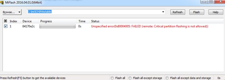

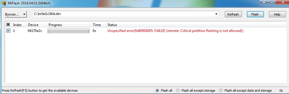

niestety. próba z global dev [00001618]CreateManagedObject(1392): Unspecified error(0x80131604) [00001618]GetFactoryObject(1436): Unspecified error(0x80131604) [00001618]CreateManagedObject(1392): An attempt was made to load a program with an incorrect format.(0x8007000b) [00001618]GetFactoryObject(1436): An attempt was made to load a program with an incorrect format.(0x8007000b) [00001618]GetFactoryObject(1457): The specified service does not exist.(0x800704db) [00001618]GetSearchPath(1512): The specified service does not exist.(0x800704db) [00001618]StartFlash(13): The parameter is incorrect.(0x80070057) [000014D4]64170e2c 0.00 execute C:\mi5sGLOBALdev\flash_all.bat [000014D4]64170e2c 0.08 [000014D4]64170e2c 0.08 $fastboot -s 64170e2c getvar product 2>&1 | findstr /r /c:"^product: *MSM8996_A7" || echo Missmatching image and device [000014D4]64170e2c 0.16 product: MSM8996_A7 [000014D4]64170e2c 0.16 [000014D4]64170e2c 0.16 $fastboot -s 64170e2c getvar product 2>&1 | findstr /r /c:"^product: *MSM8996_A7" || exit /B 1 [000014D4]64170e2c 0.19 product: MSM8996_A7 [000014D4]64170e2c 0.19 [000014D4]64170e2c 0.19 $fastboot -s 64170e2c flash xbl C:\mi5sGLOBALdev\images\xbl.elf || [000014D4]64170e2c 0.34 target reported max download size of 536870912 bytes [000014D4]64170e2c 0.34 sending 'xbl' (1787 KB)... [000014D4]64170e2c 0.34 OKAY [ 0.062s] [000014D4]64170e2c 0.34 writing 'xbl'... [000014D4]64170e2c 0.34 FAILED (remote: Critical partition flashing is not allowed) [000014D4]CScriptReport::DoWork(428): Unspecified error(0x80004005) [000014D4]GetFactoryObject(1457): The specified service does not exist.(0x800704db) [000014D4]SaveFlashResult(1478): The specified service does not exist.(0x800704db) [00001618]GetFactoryObject(1457): The specified service does not exist.(0x800704db) [00001618]GetSearchPath(1512): The specified service does not exist.(0x800704db) [00001618]StartFlash(13): The parameter is incorrect.(0x80070057) [00000DA4]64170e2c 0.00 execute C:\mi5sGLOBALdev\flash_all.bat [00000DA4]64170e2c 0.03 [00000DA4]64170e2c 0.03 $fastboot -s 64170e2c getvar product 2>&1 | findstr /r /c:"^product: *MSM8996_A7" || echo Missmatching image and device [00000DA4]64170e2c 0.08 product: MSM8996_A7 [00000DA4]64170e2c 0.08 [00000DA4]64170e2c 0.08 $fastboot -s 64170e2c getvar product 2>&1 | findstr /r /c:"^product: *MSM8996_A7" || exit /B 1 [00000DA4]64170e2c 0.11 product: MSM8996_A7 [00000DA4]64170e2c 0.11 [00000DA4]64170e2c 0.11 $fastboot -s 64170e2c flash xbl C:\mi5sGLOBALdev\images\xbl.elf || [00000DA4]64170e2c 0.25 target reported max download size of 536870912 bytes [00000DA4]64170e2c 0.25 sending 'xbl' (1787 KB)... [00000DA4]64170e2c 0.25 OKAY [ 0.078s] [00000DA4]64170e2c 0.25 writing 'xbl'... [00000DA4]64170e2c 0.25 FAILED (remote: Critical partition flashing is not allowed) [00000DA4]CScriptReport::DoWork(428): Unspecified error(0x80004005) [00000DA4]GetFactoryObject(1457): The specified service does not exist.(0x800704db) [00000DA4]SaveFlashResult(1478): The specified service does not exist.(0x800704db) i próba z china stable [00001704]CreateManagedObject(1392): Unspecified error(0x80131604) [00001704]GetFactoryObject(1436): Unspecified error(0x80131604) [00001704]CreateManagedObject(1392): An attempt was made to load a program with an incorrect format.(0x8007000b) [00001704]GetFactoryObject(1436): An attempt was made to load a program with an incorrect format.(0x8007000b) [00001704]GetFactoryObject(1457): The specified service does not exist.(0x800704db) [00001704]GetSearchPath(1512): The specified service does not exist.(0x800704db) [00001704]StartFlash(13): The parameter is incorrect.(0x80070057) [00001624]64170e2c 0.00 execute C:\mi5CHINAstable\flash_all.bat [00001624]64170e2c 0.05 [00001624]64170e2c 0.05 $fastboot -s 64170e2c getvar product 2>&1 | findstr /r /c:"^product: *MSM8996_A7" || echo Missmatching image and device [00001624]64170e2c 0.08 product: MSM8996_A7 [00001624]64170e2c 0.08 [00001624]64170e2c 0.08 $fastboot -s 64170e2c getvar product 2>&1 | findstr /r /c:"^product: *MSM8996_A7" || exit /B 1 [00001624]64170e2c 0.11 product: MSM8996_A7 [00001624]64170e2c 0.11 [00001624]64170e2c 0.11 $fastboot -s 64170e2c flash xbl C:\mi5CHINAstable\images\xbl.elf || [00001624]64170e2c 0.27 target reported max download size of 536870912 bytes [00001624]64170e2c 0.27 sending 'xbl' (1786 KB)... [00001624]64170e2c 0.27 OKAY [ 0.062s] [00001624]64170e2c 0.27 writing 'xbl'... [00001624]64170e2c 0.27 FAILED (remote: Critical partition flashing is not allowed) [00001624]CScriptReport::DoWork(428): Unspecified error(0x80004005) [00001624]GetFactoryObject(1457): The specified service does not exist.(0x800704db) [00001624]SaveFlashResult(1478): The specified service does not exist.(0x800704db) hmmm jakoś inaczej mogę spróbować?
Oba ROMy ściągnąłem z listy według poradnika. przerzuce je do katalogow bezpośrednio na C i spróbuję ponownie. Tak dla pewności, chociaż miflash znajdował pliki bez problemu. Na dole miflasha zaznaczalem flashall.bat więc to nie problem. Niepokoji mnie, że z logów miflasha wychodziłoby że walnięta partycja w telefonie. Czy jeżeli by tak było, to jest możliwość i sens (chodzi o koszty) to naprawić?

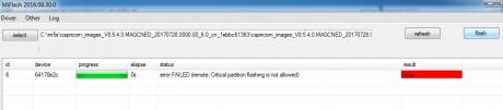

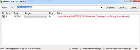

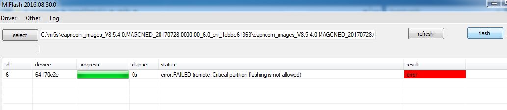

zamiast globala spróbowałem przed chwila china stable tez error, tak teraz wyglada log: [0,00 64170e2c]:image path:C:\mi5s\capricorn_images_V8.5.4.0.MAGCNED_20170728.0000.00_6.0_cn_1ebbc61363\capricorn_images_V8.5.4.0.MAGCNED_20170728.0000.00_6.0_cn [0,00 64170e2c]:env android path:C:\XiaoMi\XiaoMiFlash\Source\ThirdParty\Google\Android [0,00 64170e2c]:script :C:\mi5s\capricorn_images_V8.5.4.0.MAGCNED_20170728.0000.00_6.0_cn_1ebbc61363\capricorn_images_V8.5.4.0.MAGCNED_20170728.0000.00_6.0_cn\flash_all.bat [0,05 64170e2c]:Physical Memory Usage:573440 Byte [0,08 64170e2c]:C:\XiaoMi\XiaoMiFlash>"C:\XiaoMi\XiaoMiFlash\Source\ThirdParty\Google\Android\fastboot.exe" -s 64170e2c getvar product 2>&1 | findstr /r /c:"^product: *MSM8996_A7" || echo Missmatching image and device [0,11 64170e2c]:product: MSM8996_A7 [0,11 64170e2c]:C:\XiaoMi\XiaoMiFlash>"C:\XiaoMi\XiaoMiFlash\Source\ThirdParty\Google\Android\fastboot.exe" -s 64170e2c getvar product 2>&1 | findstr /r /c:"^product: *MSM8996_A7" || exit /B 1 [0,16 64170e2c]:product: MSM8996_A7 [0,16 64170e2c]:C:\XiaoMi\XiaoMiFlash>"C:\XiaoMi\XiaoMiFlash\Source\ThirdParty\Google\Android\fastboot.exe" -s 64170e2c flash xbl C:\mi5s\capricorn_images_V8.5.4.0.MAGCNED_20170728.0000.00_6.0_cn_1ebbc61363\capricorn_images_V8.5.4.0.MAGCNED_20170728.0000.00_6.0_cn\images\xbl.elf || [0,31 64170e2c]:target reported max download size of 536870912 bytes [0,31 64170e2c]:sending 'xbl' (1786 KB)... [0,31 64170e2c]:OKAY [ 0.078s] [0,31 64170e2c]:writing 'xbl'... [0,31 64170e2c]:FAILED (remote: Critical partition flashing is not allowed) [0,31 64170e2c]:"Flash xbl error" [0,31 64170e2c]:process exit. [0,31 64170e2c]:error:FAILED (remote: Critical partition flashing is not allowed) a tak wygląda miflash bezpośrednio po próbie flashowania walnięta partycja systemowa? sprzętowo, czy może to być błąd softwarowy?

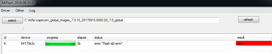

czytam, szukam, kombinuję na razie chciałem przez MiFlash. niestety - error ktos mógłby mi powiedziec co mu nie pasuje? to jest log: [0,01 64170e2c]:image path:C:\mi5s\capricorn_global_images_7.9.15_20170915.0000.00_7.0_global [0,01 64170e2c]:env android path:C:\XiaoMi\XiaoMiFlash\Source\ThirdParty\Google\Android [0,01 64170e2c]:script :C:\mi5s\capricorn_global_images_7.9.15_20170915.0000.00_7.0_global\flash_all.bat [0,05 64170e2c]:Physical Memory Usage:716800 Byte [0,08 64170e2c]:C:\XiaoMi\XiaoMiFlash>"C:\XiaoMi\XiaoMiFlash\Source\ThirdParty\Google\Android\fastboot.exe" -s 64170e2c getvar product 2>&1 | findstr /r /c:"^product: *MSM8996_A7" || echo Missmatching image and device [0,19 64170e2c]:product: MSM8996_A7 [0,19 64170e2c]:C:\XiaoMi\XiaoMiFlash>"C:\XiaoMi\XiaoMiFlash\Source\ThirdParty\Google\Android\fastboot.exe" -s 64170e2c getvar product 2>&1 | findstr /r /c:"^product: *MSM8996_A7" || exit /B 1 [0,23 64170e2c]:product: MSM8996_A7 [0,23 64170e2c]:C:\XiaoMi\XiaoMiFlash>"C:\XiaoMi\XiaoMiFlash\Source\ThirdParty\Google\Android\fastboot.exe" -s 64170e2c flash xbl C:\mi5s\capricorn_global_images_7.9.15_20170915.0000.00_7.0_global\images\xbl.elf || [0,38 64170e2c]:target reported max download size of 536870912 bytes [0,38 64170e2c]:sending 'xbl' (1787 KB)... [0,38 64170e2c]:OKAY [ 0.079s] [0,38 64170e2c]:"Flash xbl error" [0,39 64170e2c]:process exit. [0,39 64170e2c]:error:"Flash xbl error"
