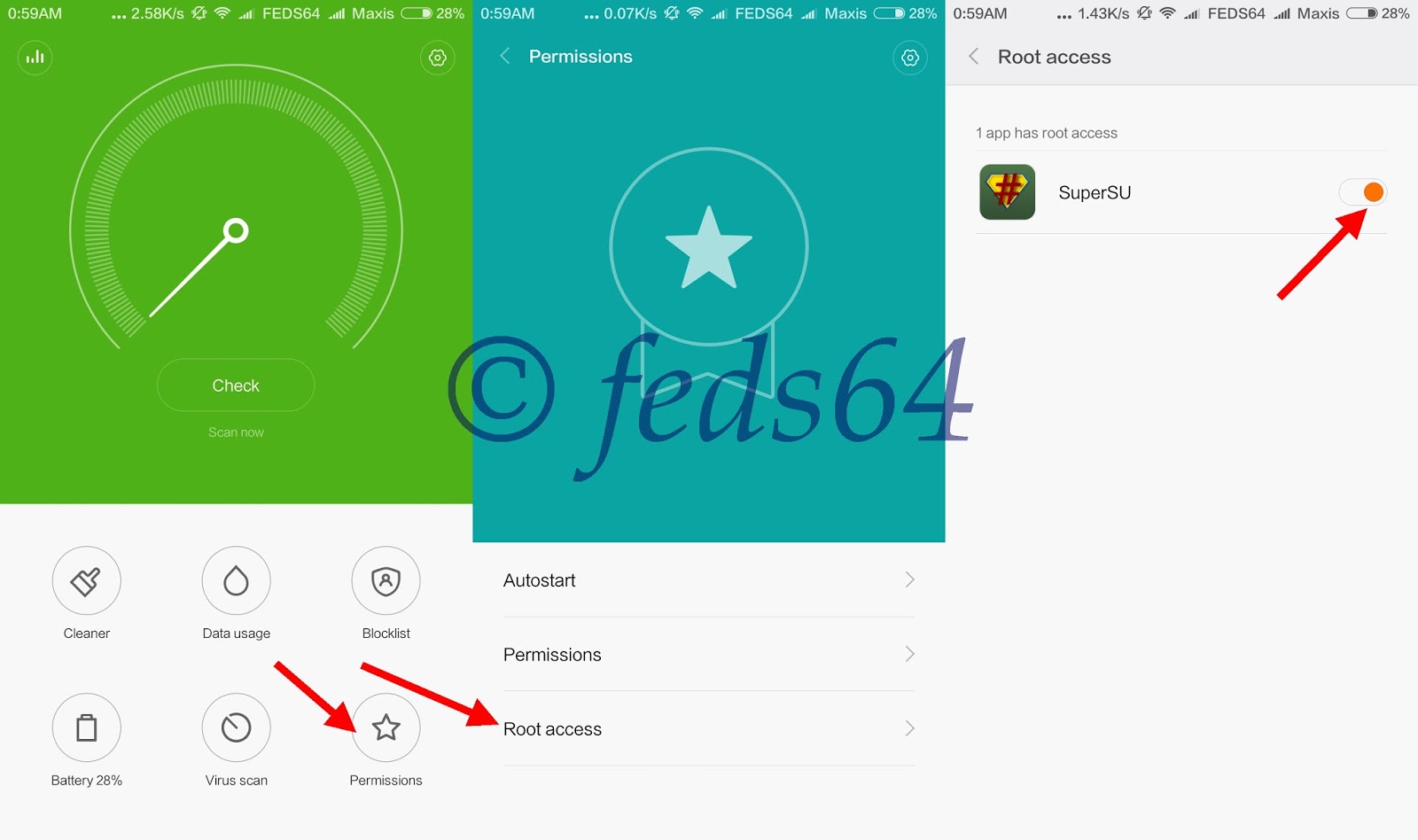

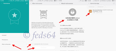

What I did was go to MIUI Forum to access my tutorial to flash using Hands-on flashing Stock ROM using SP Flash Tool on Redmi Note 3 to the Stable v7.0.19.0 and thereafter update manually thru updater to Dev v5.12.31. And on top when I wanna request for a root access, I was only granted after I did  UNLOCKING YOUR BOOTLOADER, ROOTED for REDMI NOTE 3 and successfully got thru for the third time. Only then it automatically downloaded and flashed the hennessy-5.12.31-5.12.31.root ROM, on my lappie, before I could leave for breakfast.
This how it goes, as shown below:-

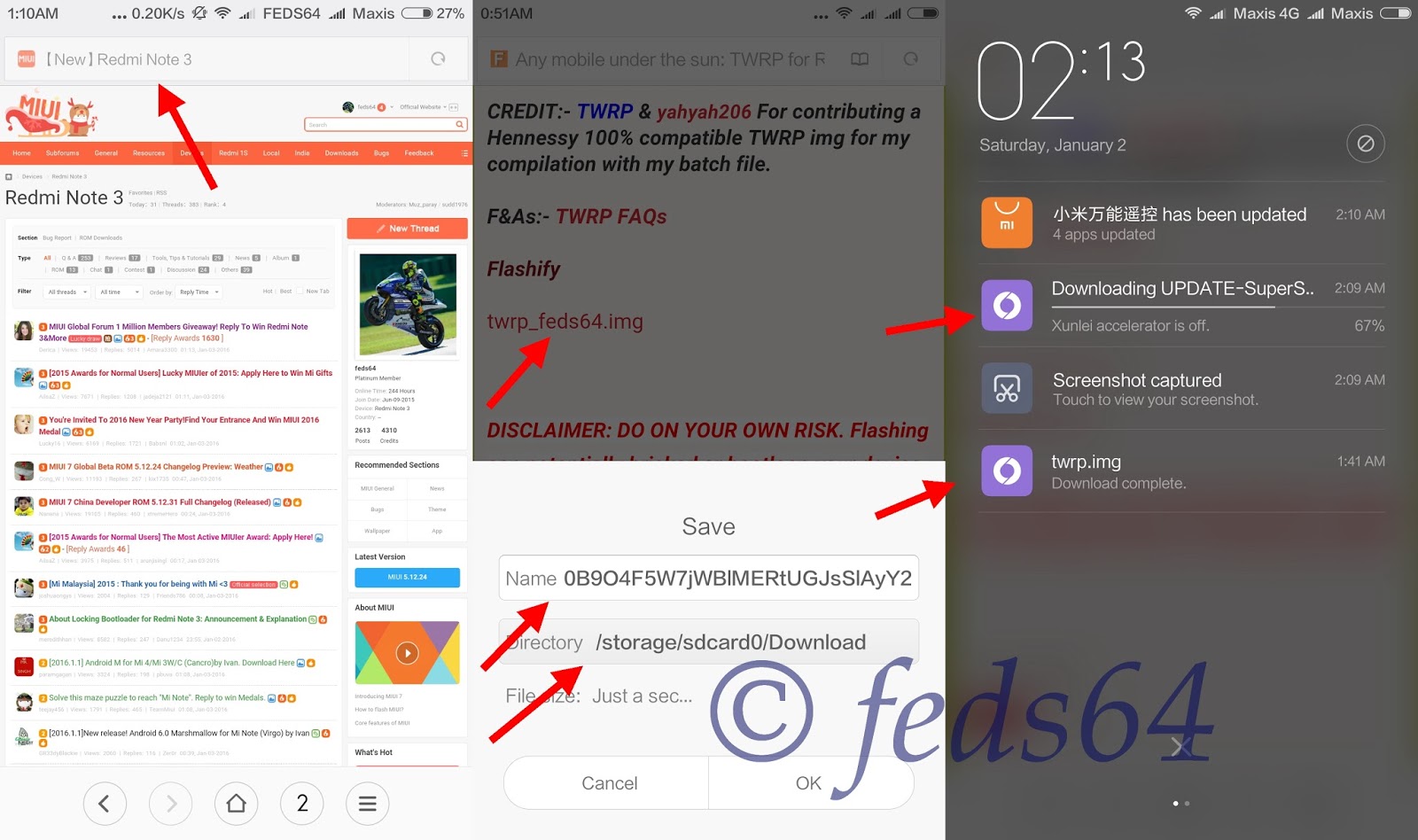

1Screenshot_2016-01-02-13-32-19_com.miui
2Screenshot_2015-12-31-17-41-14_com.miui
And the worst part is that I eager to get going with setting up, and having my eggs benedict and enjoying while it last, at a breakfast joint not at the convenience of my office or my home, so I had to do all these while on mobility and had the purple browser to connect me beyond and none other.
Hahaha... my iPhone to the rescue, my eggs benedict breakfast:-

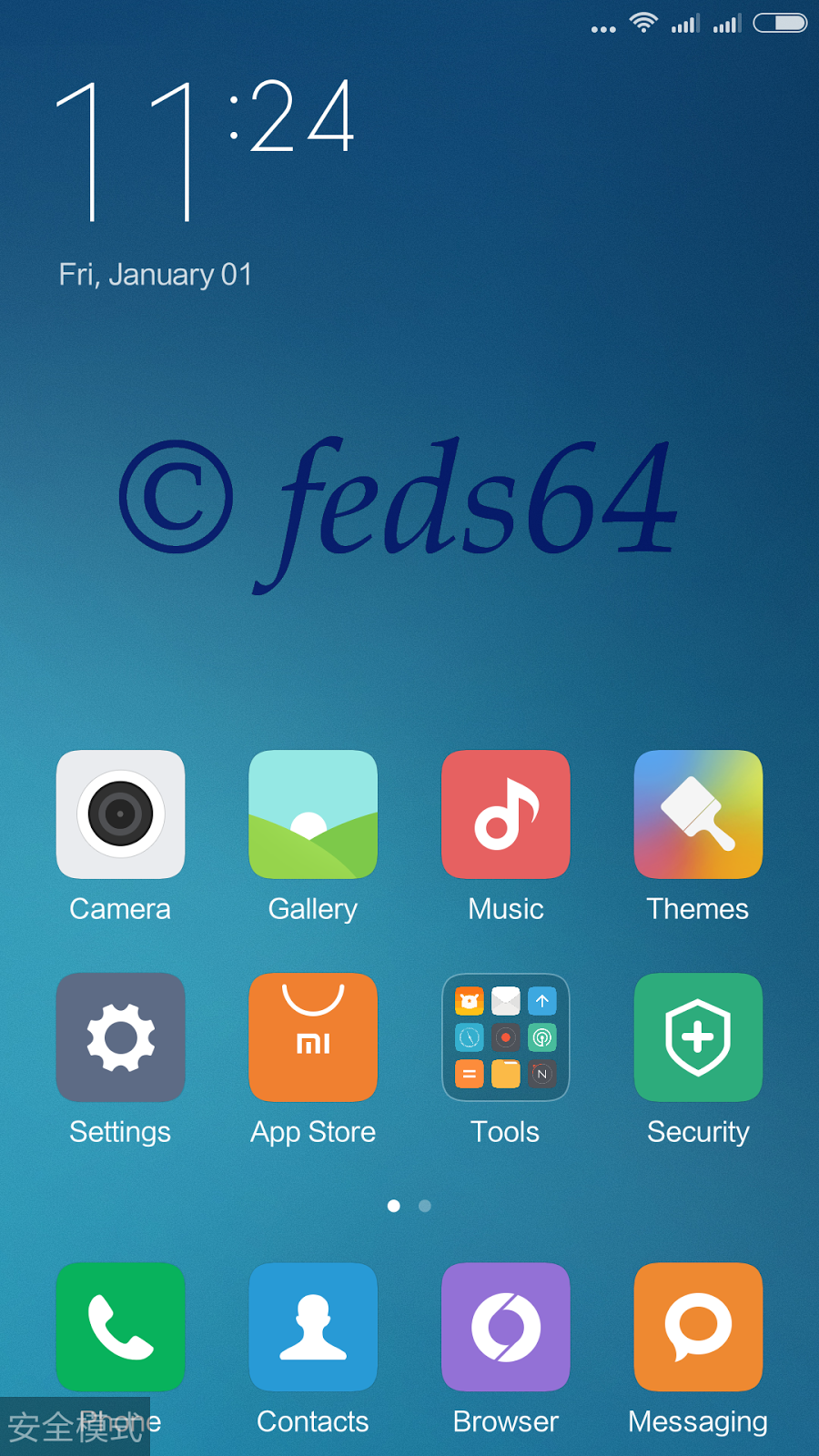

SCENARIO: I am ROOTED and WITHOUT a GOOGLE PLAY STORE. What I had to do is run to my rescue with my own blog myandroidous.blogspot.com which is like a treasure chest with all the know-hows and APP APKs at my expense, as shown below:-
3Screenshot_2016-01-03-01-10-32_com.andr
4Screenshot_2016-01-03-01-26-57_com.miui

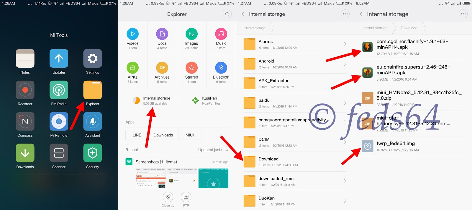

MISSION: Install SuperSU & update Binaries, Install Flashify, Flash TWRP and Ultimately Install Google Apps.
I DOWNLOADED:
SuperSU 2.46.apk
Flashify 1.9.2.apk
twrp_feds64.img
Root Checker Basic 5.5.3
REMINDER: Enable, 3rd party apk installation Installing APK file on your Redmi Note 2/Prime for noobies

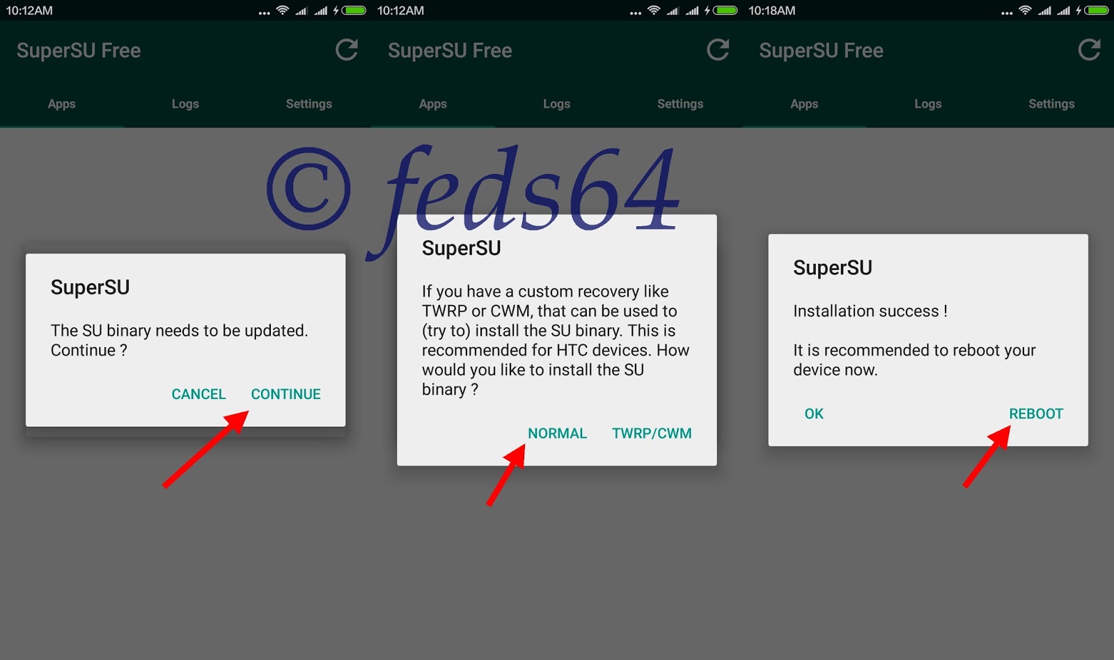

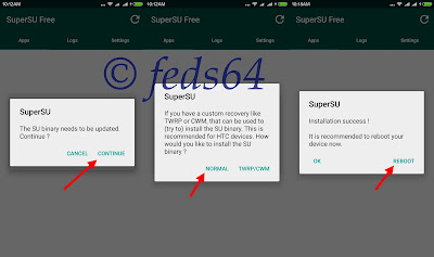

I installed and granted root access to SuperSU 2.46 and update its binaries too, as shown below:-
5Screenshot_2016-01-03-00-59-06_com.miui
6Screenshot_2016-01-02-10-12-33_eu.chain

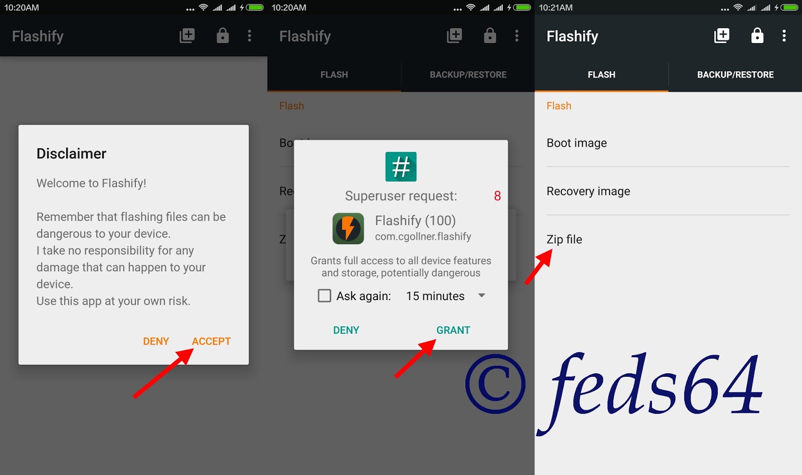

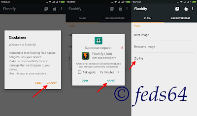

Installed Flashify and flashed recovery twrp_feds64.img as shown below:-
7Screenshot_2016-01-02-10-20-33_com.cgol
8Screenshot_2016-01-02-10-22-13_com.cgol

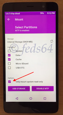

And now, I have successfully flashed TWRP recovery to my Redmi Note 3, and I "Only mount system read-me" cos I do not want to lose my OTA updates, as shown below:-
