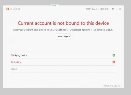

Mam błąd "Current account is not bound to this device"
