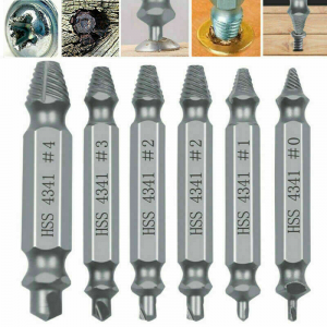

Gregorio_Es Posted September 26, 2021 Share Posted September 26, 2021 (edited) istnieje jeszcze inna metoda - wykrętaki. z jednej strony masz wiertło, z drugiej lewy *gwint* Edited September 26, 2021 by Gregorio_Es Link to comment Share on other sites More sharing options...
