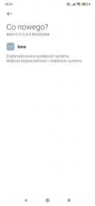

GKers Posted November 8, 2021 Share Posted November 8, 2021 Nowa aktualizacja 😉 Link to comment Share on other sites More sharing options...
