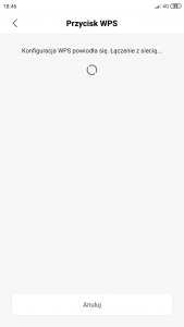

tomkill Posted December 28, 2018 Share Posted December 28, 2018 tez mam problem z funboxem ,internet dziala na laptopie na innym telefonie ale na moim xiaomi mi6 nie dziala wifi ,internet mam od neostrady,ktos wie jak to naprawic? Link to comment Share on other sites More sharing options...
tomkill Posted December 28, 2018 Share Posted December 28, 2018 wszystko naprawilem okazalo sie ze musialem takie cos zrobic:(patrz foto) Link to comment Share on other sites More sharing options...
