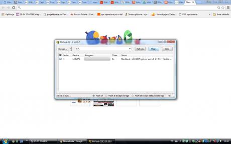

festor89 Posted October 7, 2015 Share Posted October 7, 2015 niestety dalej to samo Link to comment Share on other sites More sharing options...
janusz_zed Posted October 8, 2015 Share Posted October 8, 2015 (edited) przez browse wrzuć samo image z rozpakowanego rooomu Edited October 8, 2015 by janusz_zed Link to comment Share on other sites More sharing options...
