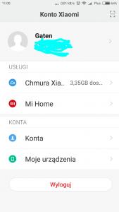

SLiM Posted December 11, 2016 Share Posted December 11, 2016 @jolusiasprawdź w ustawieniach zakładka konta, jakie tam są dodane i czy jesteś zalogowana. Link to comment Share on other sites More sharing options...
jolusia Posted December 11, 2016 Author Share Posted December 11, 2016 Mam tak jak na fotce poniżej : Link to comment Share on other sites More sharing options...
wulfel Posted December 11, 2016 Share Posted December 11, 2016 Czyli masz ok, z kontem wygląda to tak. Link to comment Share on other sites More sharing options...
