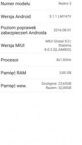

cukru Posted December 7, 2016 Share Posted December 7, 2016 @exe To pokaż jeszcze screena z informacji o telefonie, to zobaczymy jaki masz soft. Link to comment Share on other sites More sharing options...
exe Posted December 7, 2016 Author Share Posted December 7, 2016 (edited) Takie coś Edited December 7, 2016 by exe Link to comment Share on other sites More sharing options...
cukru Posted December 7, 2016 Share Posted December 7, 2016 @exe Wygląda na oryginalny, więc to raczej wina szkła. Link to comment Share on other sites More sharing options...
