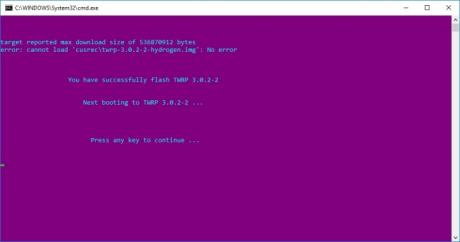

ruemere Posted August 9, 2016 Share Posted August 9, 2016 Dla formalnosci, linki dla zainteresowanych: [RECOVERY][Xiaomi Mi Max Pro][helium] TWRP 3.0.2-0 touch recoveryhttp://forum.xda-developers.com/mi-max/development/recovery-twrp-3-0-2-0-touch-recovery-t3435591 Download:https://dl.twrp.me/helium/twrp-3.0.2-0-helium.img.html Regards, Ruemere Link to comment Share on other sites More sharing options...
